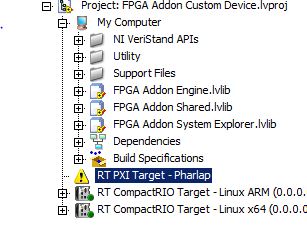

A LabVIEW 2015SP1 project for the FPGA Custom Device for VeriStand 2015SP1 needs additional driver for the PXI Pharlap system. So far I have only RSERIES15.5, CRIO15.5 and PXIPS15.0 installed. What drivers are necessary for the RT PXI Pharlap?
(3,177 Views)
Ok, after the additional installations of the default LabVIEW HIL and Real-Time Test Suite 2015SP1 the RT PXI Pharlap is recognized in the project.
