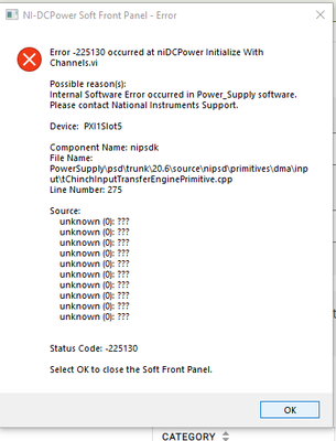

PXI-4139 Status Code: -225130
I have updated the PC to the latest Dell BIOS update and moved the card to different slots.
This card passes self test  but fails calibration and the error below occurs when using the soft panel.
Is this a bad power supply module or bad SW environment.

"Internal software error" typically indicates that something is wrong with the HW & its firmware. If you recently upgraded any software such as drivers or windows, I would recommend reverting them to see if it is resolved. If it doesn't work, best to reach out to NI support but for that you would need an active SSP.
