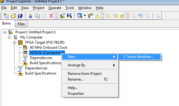

Step 5...
Step 6...If you have the module connected to the chassis, you should be able to see the module in the list:

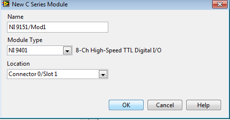

Step 7...If the module is not connected, you can just select "New Target or Device" from the menu in step 6 and add a new target as follows:
