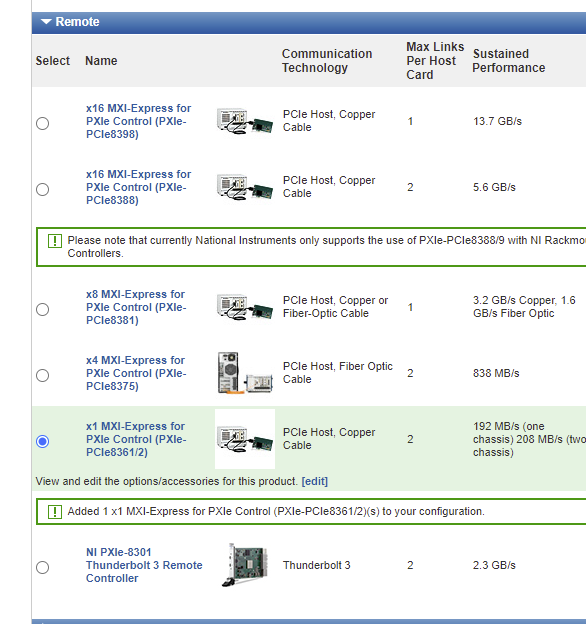

A PXIe or PXI chassis is an extension of the PC's PCI or PCIe bus. This means that the PC is the brain of the operation and this chassis is just an extension.
The PXIe or PXI chassis being an extension cannot function on its own as it has no brain. There are multiple forms of extension - use an embedded controller (full-fledged PC that plugs into the chassis, like inserting the brain directly into the chassis) or MXI or Thunderbolt 3.
The PC has to be present at slot 1 - this is why you can insert the embedded controller or the MXI control card only at slot 1 and nowhere else.
If you don't want to spend on an embedded controller, the only other alternative is to use a remote control module - either MXI based or Thunderbolt 3.
Correction, it is PXI-8360 and not PXIe, this is NOT compatible with a PXIe chassis.
These are the compatible modules I see with PXIe-1071 listed in the PXI advisor
