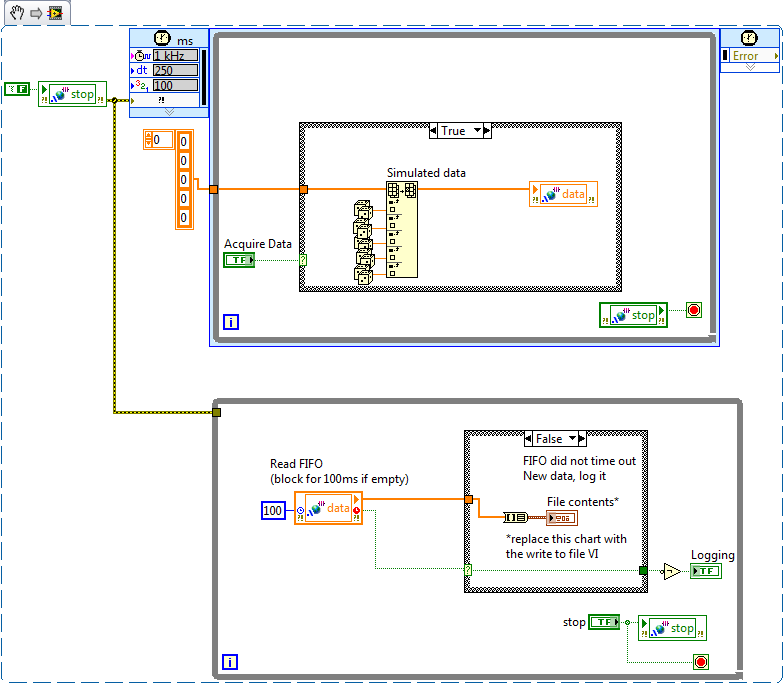

FireIce,
There are two primary things I would change in your logging state.
1) Use a regular while loop for the consumer loop
2) Change the global variable to an RT FIFO
Right now you have a single element variable to transfer data between the loops; effectively a register. For your use case (streaming data to a lower priority loop) it is better to use a FIFO that can hold many elements until they can be logged by the consumer loop.
The consumer loop here is data driven rather clock driven. This allows the consumer loop to sit and wait for data to be present. Then when there is enough processor time (the timed loop is not busy) the regular while loop will run as fast as it can until the timed loop interrupts it or until the FIFO times out (is empty).
This will prevent you from logging duplicate data and from losing data in the case that the file I/O takes longer than it should.
Hope this helps!
Kurt
