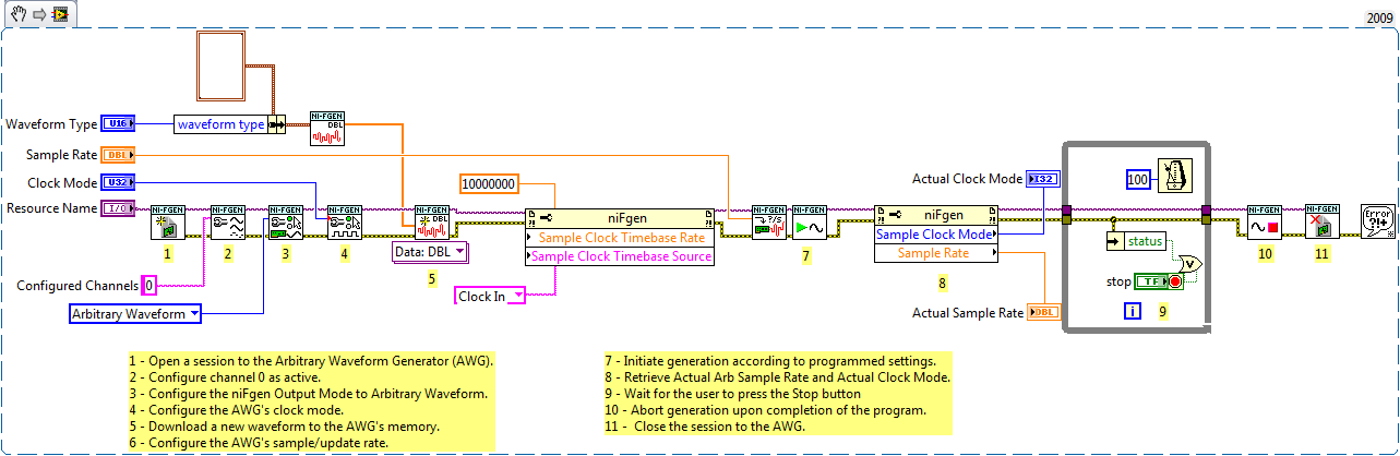

Yes you can do this. In order to do this in LabVIEW, use the property node called Sample Clock Timebase Rate and Sample Clock Timebase Source. I modified one of the example VIs and have a picture below for you to consult.

I tried your example. It works, but it works with onboard clock anyway, although the niFgen.Sample Clock Timebase Source  is “Clock In”. In other words in this example PXI-5441 generates waveforms without external clock.

Hello Jim,
You are right. Really when I don't provide a clock on the Clock In it works. I believe it works properly if I set Clock In to Sample Clock Source and value of frequency (1000000) to Sample Rate.

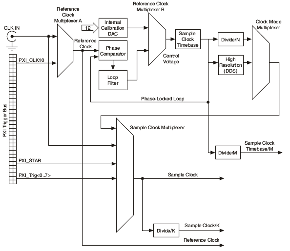

Second, the reason why I thought this was possible was because of some confusing documentation in the FGEN Help. In the help it states under the device that the Clock In can accept an external Reference clock, external Sample clock, or external Sample clock timebase. This lead me to believe that this was possible but alas it isn't.
Knowing this, we do have some other tools to be available to us to get this down. In order to look into this, we need to consult the timing diagram for the 5441/5442. For this case we can look at either of them because the functionality is the same for Clock In. Here is the timing Diagram for the Help:
There are two things we can do. First we can PLL the the external 10MHz clock with the Sample Clock Timebase (top section of the timing diagram). Now that the device's timebase has been PLLed to your external 10MHz signal, we can create a 1 MHz signal from the timebase that will be in phase to your external signal. In order to do this, you can use the niFGEN Configure Clock VI to employ this.

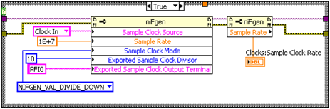

The other way we can implement this is to use the Clock In as the Sample clock and use the divide down (Sample clock/K) to have it divide it down. In order to do this, we will have to set the Sample Clock Source, Rate, Sample Clock Mode (Divide Down), and the Exported Sample Clock Divisor (10 in this case). These property nodes can be found under Clocks >> Sample Clock.
Sorry for the confusion but this should straighten everything up.

Hello Jim,
I haven’t done the first version you recommended so far. In the second version, Exported Sample Clock really is 1 MHz (I can see it if I export sample clock to PFI0 terminal). But the Sample Clock Rate isn’t changed (10 MHz).
