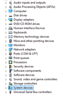

2, We then flipped the switch on the PCIe-8381 card and installed the MXI compatibility software, now the desktop can boot. The LED indicator on PXIe-8381 is solid green. However, neither MAX or Windows Device Manager see the NI hardware. Please see the image below from the Windows Device Manager.
I am wondering if this indicates any hardware issue on the PXI chassis or a damaged 8381 card and should ship the hardware to NI for inspection.
I appreciate any insight you may share. Thanks.
