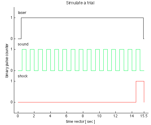

Hi, guys!
Here how far I got. I use now the niDAQmx C API together with MEX to incorporate it in Matlab. I found out how I can generate a TTL pulse using the clock signal:
float64 initialDelay;
float64 lowTime;
float64 highTime;
uInt64 periodsPerTrain;
float64 maxTime = (lowTime+highTime)*periodsPerTrain + 2*initialDelay;
// Configure Pulse
DAQmxErrChk(DAQmxCreateTask("", &taskHandle));
DAQmxErrChk(DAQmxCreateCOPulseChanTime(taskHandle, "PXI1Slot2/ctr0", "", DAQmx_Val_Seconds, DAQmx_Val_Low, initialDelay, lowTime, highTime));
// Configure Pulse Train
DAQmxErrChk(DAQmxCfgImplicitTiming(taskHandle, DAQmx_Val_FiniteSamps, periodsPerTrain));
// Start Train
DAQmxErrChk(DAQmxStartTask(taskHandle));
// Wait for execution
DAQmxErrChk(DAQmxWaitUntilTaskDone(taskHandle, maxTime));
// Clean up
DAQmxStopTask(taskHandle);
DAQmxClearTask(taskHandle);
 My next problem is how to generate more than one Pulse Train and that they are synchronized? What I aim for is on the plot (attached image).
Further problem is I am using the BNC2111 connector. Which are the physical channels to be used? At the moment /PXI1Slot2/ctr0 goes to PFI12/P2.4 . But If I create more signals how will I redistribute them on the connector?
Any comments and tips are welcomed!
Thank you in advance!
(7,903 Views)
