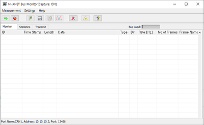

these days I'm trying to CAN communication using PXI-8512/2.
I can take correct signal with CANoe.
but I can't take a any answer from Xnet Bus monitor.

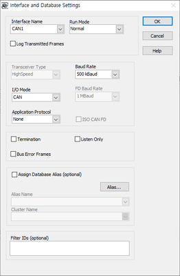

so I change the properties (enable, listen-only)

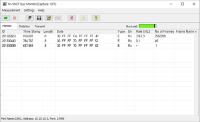

only in case of setting as listen-only mode, I can see the CAN value.
anyone who knows this problem. I need your advices.
thank you.
Case 1. enable listen-only mode
Case 2. disable listen-only mode

Based on the screenshot provided, when it is in Listen-Only mode, the Bus Monitor is only showing error frames (the type is E which stands for Error).
I would suggest you try enabling Termination if your wire is not terminated.
