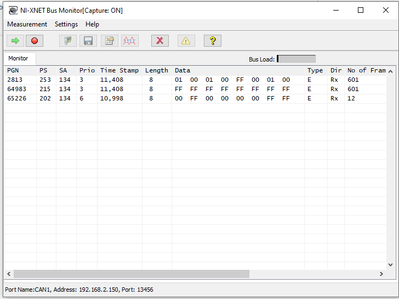

Sorry, I made a mistake about connection and fixed that. PXI 8513 can see data in the bus Monitor. I want to see the data in LabView, but I will have an error "Error -1074384758 occurred at XNET Create Session". How can I fix this issue?

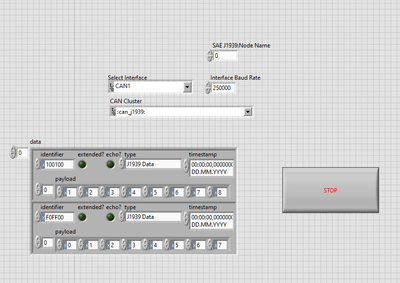

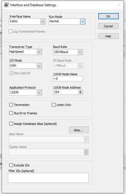

Actually, I have an issue in LabView . I entered node name, interface and baud rate correctly from NI-XNET Bus Monitor.
Model is same J1939 Frame Output Stream.vi example project. When I run the project, this error will occur:
NI-XNET: (Hex 0xBFF6308A) The interface name given does not specify a valid and existing interface. Solution: Use a valid and existing interface. These can be obtained using MAX, XNET system properties, or the LabVIEW XNET Interface IO name. If you are using CompactRIO, refer to the topic "Getting Started with CompactRIO" in the NI-XNET Hardware and Software Help.
I don't know how to fix this issue.

Can you also provide the screenshot on the front panel?
 Sorry reply late, I am using RT and NI-XNET 20.0
