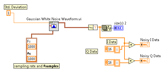

Hello Robert !
Thank you for the tip ! It works great.
However, by doing a point-to-point add to the IQ arrays, the generated signal becomes  [I(t)+N(t)]*sin(2*pi*f_carrier*t) + [Q(t)+N(t)]*cos(2*pi*f_carrier*t)
instead of I(t)*sin(2*pi*f_carrier*t) + Q(t)*cos(2*pi*f_carrier*t) + N(t) where N(t) represents the added noise.
Any idea how to generate a  I(t)*sin(2*pi*f_carrier*t) + Q(t)*cos(2*pi*f_carrier*t) + N(t)  signal using NI RFSG in Arbitrary Waveform mode ?

I may still be not completely understanding exactly what you're asking for. So in my example that I gave you, we were adding the AWGN to both the I and Q arrays seperately. What you're looking for is to actually add the noise to the signal after it has been upconverted. Does that sound right? With our hardware, this is not possible because the baseband I/Q data is mixed with the carrier in hardware as the last step before it is generated. To add AWGN after the signal has been placed on the carrier you would need a noise generator. The best you can do is to add the AWGN to the baseband I/Q and then upconvert it based on the carrier frequency you specify in RFSG. Let me know if that was helpful to you.
