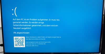

i have an PXIe-1084 chassis with seven PXI-Cards installed. Last week i installed an eighth card (PXI-6514) at the eighth slot. After i switched the chassis on, my Laptop, which is connected via Thunderbolt to the chassis, crashes with a bluescreen.

So it seems evertime i install a PXI-Card in a higher slot then the seventh slot, i get a bluescreen. Its always the same bluescreen:
Has someone an idea how to fix this?
