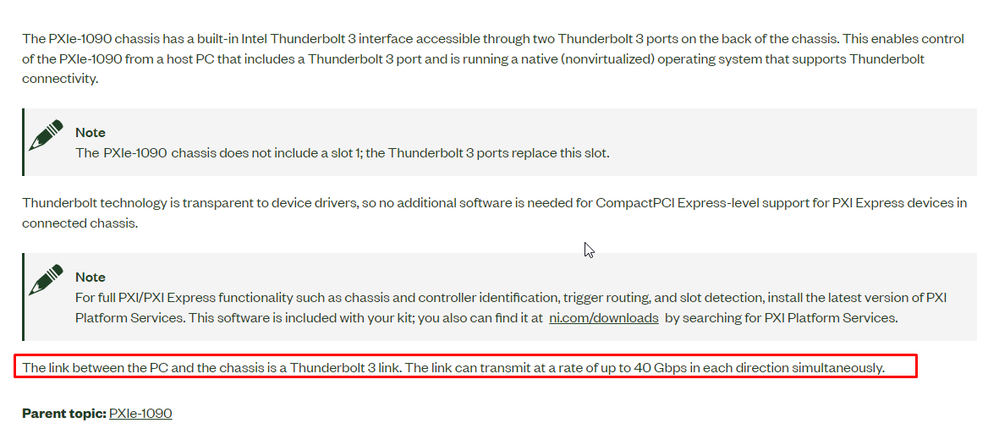

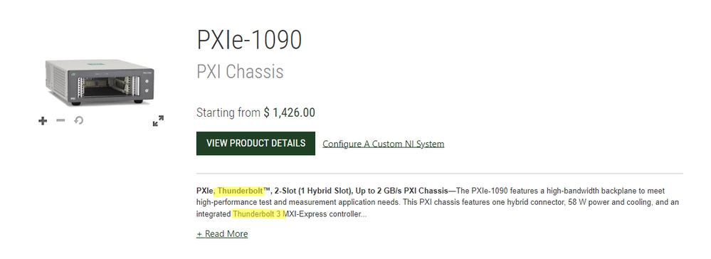

As Robert pointed out, you need at least Thunderbolt 3 - refer to the documentation here
This should be evident from the product page too
Yes, it is an absolute requirement for Thunderbolt for this to function as both Thunderbolt and PXIe are built on top of the PCIe bus.
