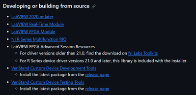

If you just want to use it, you can download the compiled files from Releases · ni/niveristand-fpga-addon-custom-device
If you want to modify the source code, you would need to install all the dependencies.
