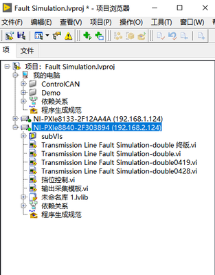

Hello sir
I am using NI PXIe-8133 with my project and now I want to use the same project with NI PXIe-8840
I create and pull the PXIe-8840 in real-time PXI, after that i add all of the VI and SubVi. when i run the program in real-time it shows an error "Error - 200220 occurred at DAQmx Create Channel (Al-Voltage-Basic.vi: 1780001)
Possible causes:
The device identifier is invalid.
Specified device: PXI2 Slot 5
Recommended Devices: PXI1 Slot 7, PXII1 Slots 14
Task Name: unnamed Task < 175A >
Continue"
(1,995 Views)
