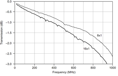

If you want to calibrate the path, you need to measure the insertion loss with your specific 2593 channels.
From spec sheet
If NI did not publish the insertion loss of the relays, you would need to raise a technical support ticket for them to look up and answer. Sometimes, it is not even available to share.
