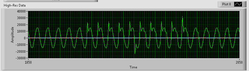

While most of the output looks ok (i.e. the waveforms look like the input signals), I get many bursts of corrupted samples. I often get spikes that equal the max/min value of I16, although there are cases of non-max spikes too.
Interestingly:
  • Each FlexRIO card seems to have exactly 1 misbehaving channel.
  • The channel varies across cards (e.g. RIO1 gets spikes in AI0, while RIO2 gets spikes in AI3)
  • When I repeatedly trigger acquisition on the same card, I see a very similar "noise shape" each time. Different cards produce different "noise shapes".
  • I don't observe any spikes when I use the pre-built FIDL examples instead of my own code (perhaps I need to do some kind of synchronization??)
Screenshots below.
  • The orange graphs are supposed to be all zeroes.
  • The green graph is supposed to show a clean sine wave.
What might the problem be, and how can I fix it?
Thanks!
Zoomed in

You need to acquire data from the 5734 in the Sample Clock domain. Reading from the AI Node in any other clock domain causes the glitching you are seeing.
