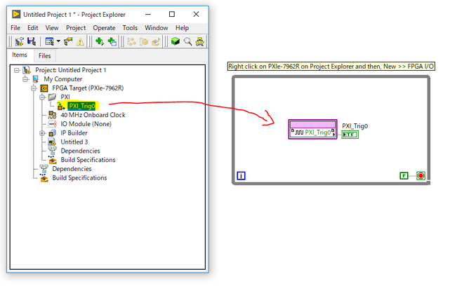

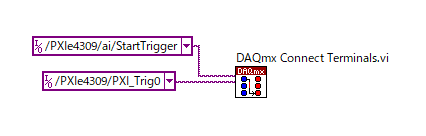

Hi Oliver, yes it is not difficult.
DAQmx
FPGA

(1) In my design, the destination term is indeed PXI_Trig0, but the source terminal it should be AI0, an analog input. I need to detect the rising edge of the analog signal at AI0. Is it still right to use the source terminal as StartTrigger in your image?
(2) I need to detect the rising edge at the speed up to 80 MHz. Do something else modules in DAQ need to be set up?

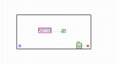

(3)

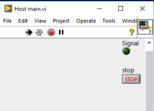

The input signal to AI0 is a pulse signal with 1 Hz, 5 Vpp. The result shows the 'signal' light is zero.
Host Design
FPGA Design
Result

You don't generate any trigger signal on DAQmx, FPGA doesn't detect it never.
For example,
Generate Pulse on Counter --> Counter signal is routed to PXI_Trig --> FPGA read PXI_Trig
Try it on.
