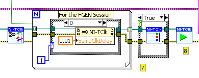

There's an example dealing with your particular setup (synchronizing AWG with a HS Digitizer, that is), you can find it here. Could you test your setup using this VI?
Also, to correct for propagation delays in slave devices, you can add some delay in the master (the FGEN in our case).
What was the sample rate in the picture you've attached? Since I'm assuming you're using loopback to test synchronity, there should be some delay between the AWG and digitizer, to account for propagation delay of the DAC + wire + ADC.

I've tried to make the modification you've suggested. However, the difference between TClk and ordinary triggering persists. I ran the NI provided example, I've also added the TClk delay to my code (with the smaller delay - 5412 refuses to use 0.01, the value is out of range) and ran it. The good thing though is, that all these programmes produce the same signal (one group in the fig.)- regardless of TClk delays and other modifications. The bad thing is, that it's still way different from RTSI0 triggering with StartedEvent or MarkerEvent set to 0 (the other group in the fig. ).
Attached you can see the comparison for first few samples, done after the measurement using the stored data. Signals were collected at 10 MS/s, 1000 samples, DC coupling, 50 Ohms - direct from AWG to DAQ via 10 cm long cable. I agree, that there is an intrinsic delay caused by circuitry and physics. The difference here is approximately 10 samples (1us) and I'm not sure if it's really caused by this.
Any other ideas why are RTSI0 and TClk triggering so different in my application?
