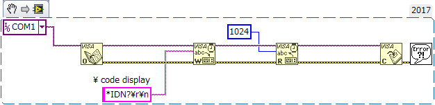

Can you share any examples for the same (using NI-VISA function to use USB port of PXI in Labview); if you already have any?
Message 9 of 11
(4,605 Views)
The application is easier than you consider.
Certified LabVIEW Developer
GCentral
Message 10 of 11
