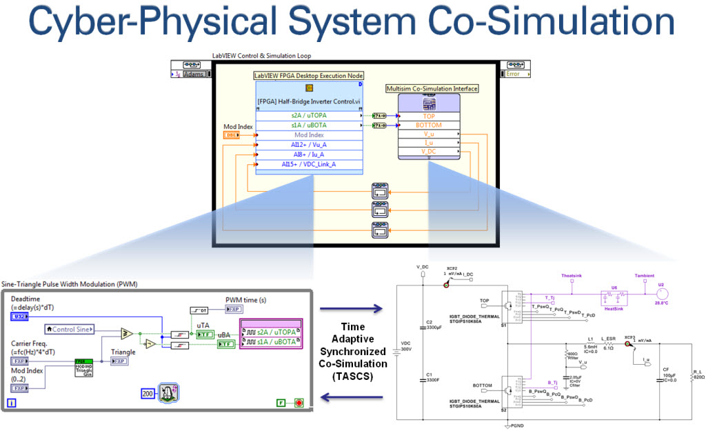

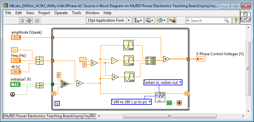

3-Phase Source Signal Generator Subsystem (control signals for sine-triangle PWM):3-Phase Source Signal Generator.png
