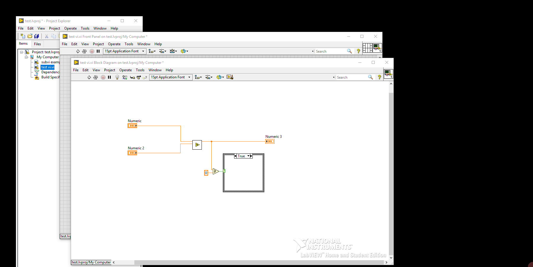

The animated GIF below show the three possible options of the plugin:
  • Add/Remove a label to a SubVI.
  • Add/Remove a subdiagram label to a structure element.
  • Add/Remove a label to a wire
  • Show again an already set wire label
Using the plug-in
It is also possible to select more than one element within a blockdiagram. Therefore the appropriate label will be added to the selected elements.
