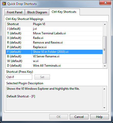

I have installed this plugin as specified above, but it does not show up in the "Ctrl-Key Shortcuts" window, could there be something I am doing wrong?
Many thanks, Alec
Message 5 of 9
(10,813 Views)
The vi's path is:
C:\Program Files\National Instruments\LabVIEW 2010\resource\dialog\QuickDrop\plugins\Show VI in Folder.vi
Message 6 of 9
(10,813 Views)
Did you copy the 2010 version?  I see it just fine in the Ctrl-Key Shortcuts tab in my LabVIEW 2010:

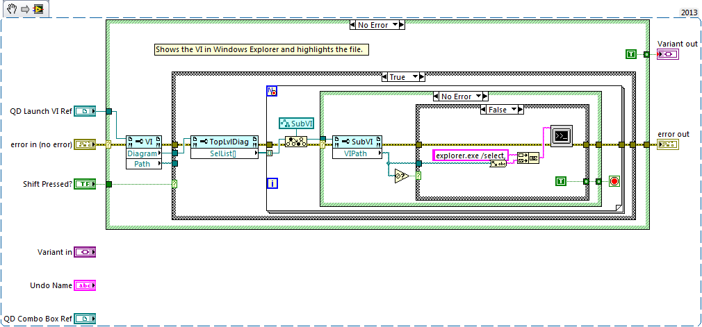

Nice feature.
The following snippet add feature to show selected subVI in the Windows Explorer when shift is TRUE.
George Zou

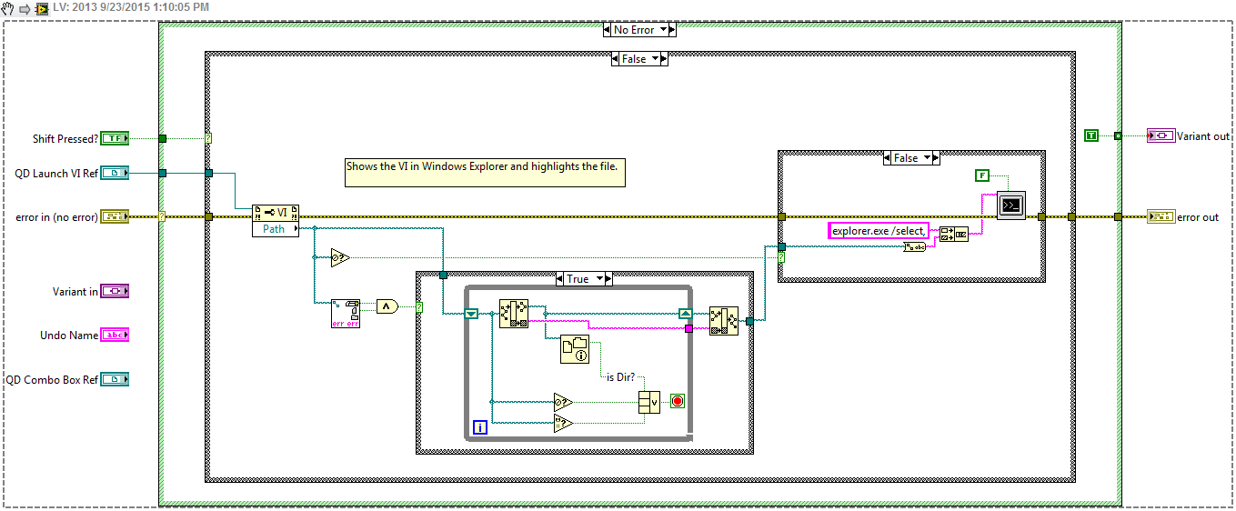

I modified this too.  I updated the search so that if a file isn't in a folder, it keeps going up until it is in a folder.  This can happen when you try to open explorer to a VI in a LLB.  My method will keep going up then open explorer to the folder the LLB is in, and then select it.
I also modified it so that if you hold Shift the path to the VI is copied to the clipboard.
