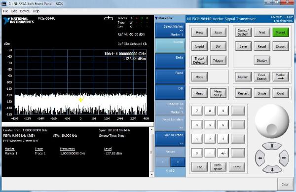

Do VI's like this one come with the VST Device?
Do fancy VI's like this come with VST hardware?

Hi Richard,
This is the RFSA Soft Front Panel that can be downloaded for free from ni.com by downloading the NI-RFSA driver located at:
NI-RFSA 2.7.5
http://joule.ni.com/nidu/cds/view/p/id/4133/lang/en
Once you have downloaded and installed this driver, you can access the Soft Front Panel by navigating to Start >> All Programs >> National Instruments (folder) >> NI-RFSA >> NI-RFSA Soft Front Panel.

Hi Richard,
The NI-RFSA Soft Front Panel (SFP) that you have a screenshot of is installed by the NI-RFSA driver software as Kaitlin describes, and the driver software ships with VSTs.
So the answer to your question is yes. Hope this helps.
