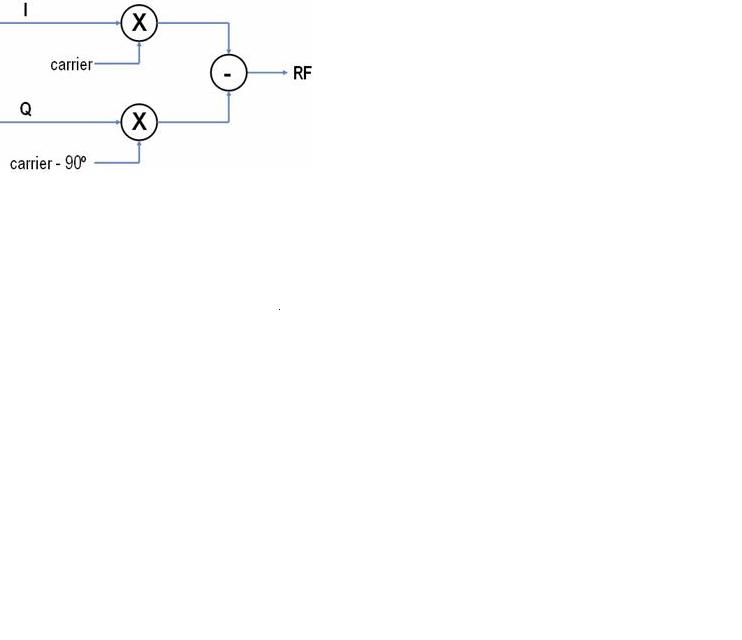

I would like to select PXI 5670 to generate the QPSK signal in my system. How does is it make the QPSK modulation?As I understand, QPSK modulation would need to have two AWG to generate the I and Q signal. See below:
But PXI 5670 only integrated one AWG (PXI 5421). So how does it make the QPSK modulation?

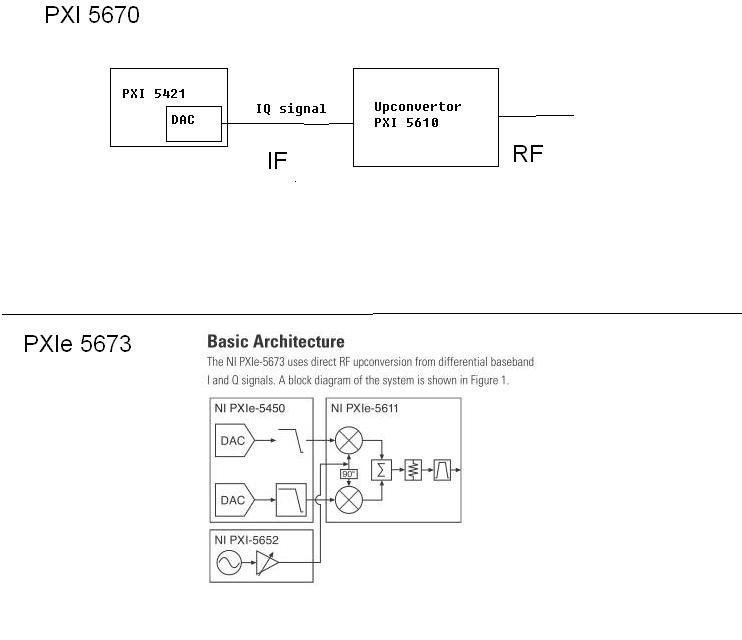

Base on your information, it seems that the modulation toolkit create the IQ signal's waveform and than the AWG output the IQ mixed signal (contain the I and Q signals information ) in one  single channel,after that upconvert it to the RF IQ signal (which is we need) by the upconvertor. It sounds like the modulation is done by the software,let's said "sofware-modulation".How about the PXIe 5673? It should not be the same, right?As I see, I has two independent AWG output. So it should be no need to create the IQ signal wavefrom in the memory first, since it's capable of outputing the I and Q signal respectively,and then modulated by the upconvertor(let's said hardware-modulation).That means, for PXIe 5673, we should no need to worry about the play-back time which is limited by the memory size+IQ data rate.A simple diagram is as  below:
Is it correct? Please kindly correct me if I get any misunderstanding.

This is correct given the PXIe-5611 performs the complex modulation and direct upconversion in the physical analog domain. Typically, you will still be generating your waveform in software based upon I and Q however. The real I waveform will be generated on channel 0, and the real Q waveform will be generated on channel 1. The I and Q analog waveforms will then be modulated in a quadrature fashion and generated at the appropriate RF frequency.
The fundamental difference between the PXI-5670 and PXIe-5673 is that your the PXI-5670 eventually needs to received a waveform at full rate (100 MS/s) which has already been complex modulated while the PXIe-5673 only requires two real waveforms, I & Q, which can be at streamed to the device at a decimated rate since the onboard signal processing supports interpolation. This allows the PXIe-5673 to be an ideal streaming platform. It is also much faster in regards to tuning, and is capable of a 4x instantaneous bandwidth improvement - the PXI-5670 is 20 MHz, while the PXIe-5673 is > 100 MHz in bandwidth.
Check out the specifications for the PXIe-5673 for more detail on the overall device, as well as the PXIe-5450 specifications for more detail on the onboard signal processing capabilities.
