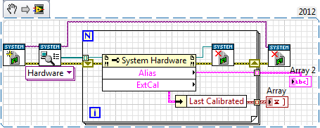

Although, it would be nice if the external cal date was actually populated when shipped.
Could you clarify your statement? When I run Get External Cal Info.vi from the project I sent you, I get cal data:
Is that not what you get?
Error 1556

@Elizabeth_K. wrote:
Hi Jeff,
Nope, I get Epoch on at least the first of 12 VSTs and at least the first of 14 PXI 6509's the DMM (PXI 4065) is OK though
Ahh Those two devices don't have that property! D'oh  OK strike that one off the list
