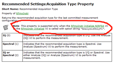

  • RFmx SpecAn instr recommended acq type property read out value is always IQ. But RFSA is spectrum.
         RFmx SpecAn instr recommended acq type property is only used when the T=RFmxInstr Initialize NIRFSA VI or the RFmxIntr Initialize VI is called with option strings "AnalysisOnly =1", as below. Or else, the property is meaningless.

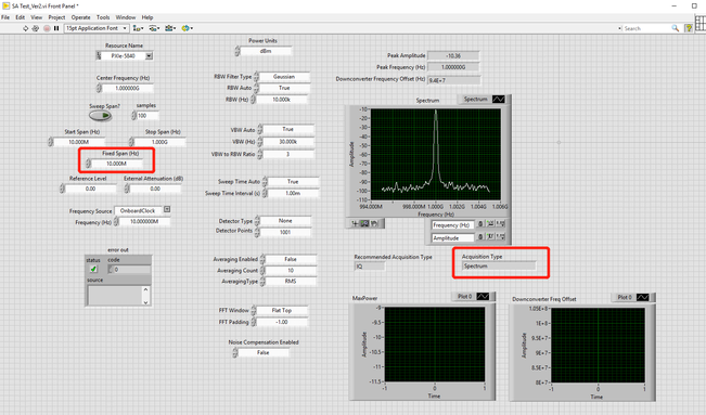

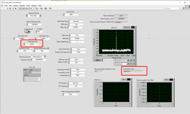

  • For 5840, Rfmx SpecAn CHP span higher than 300MHz, instrument will be switch to spectrum which is not necessary and this property can't be change to IQ from either rfmx or rfsa property.
        As the example on attachment, it can't reappear your phenomenon.

Hi Smart,
1. At Spectrum mode, the LO frequency of the instrument is done automatically and without your control, but what that means is that your tone will lie at different frequencies in the instantaneous BW of the HW under different conditions.
2. At IQ mode, you can better control the offset for specific LO frequencies.
3. At RFmxApecAn CHP Test, the aciquisition type is related with instantaneous BW. When Span is lower than instantaneous BW, the aciquisition type is IQ mode; Or else higher than instantaneous BW, it is spectrum mode. You can refer to the attachment example VI.
