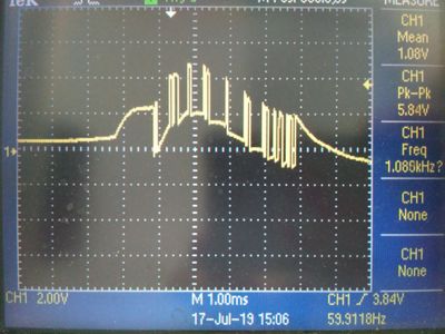

With Slave connected to cRIO RS-485 port:

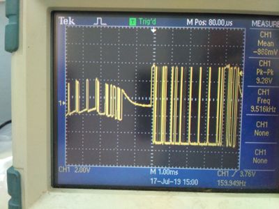

With Slave disconnected from cRIO

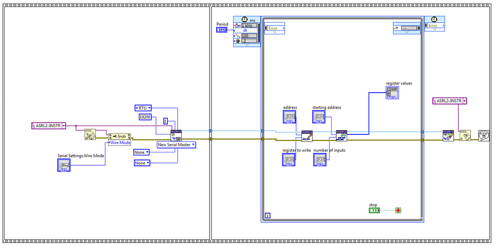

My RT vi is like that:
