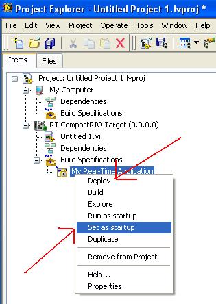

Also, if your using the project environment you don't really need to set the ini files yourself.  You can set an executable to be startup by a right click option, setting it to a startup, and then deploying it to the RT device.
