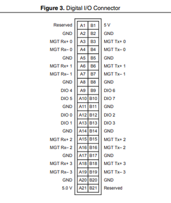

I have to use my PCIe FlexRIO 5763 synced with a modulator, but the output current of DIO is simply too weak, it can only handle 100uA current when handling MHz signal, I have to build a simple TTL driver PCB to make sure it can properly drive my 50-ohm input modulator.
I check my FlexRIO spec file, getting started guide, and NI site, but not found the information about this connector, there are descriptions about what kinds of single does this Nano-Pitch contains, but nothing about which pin carries which signal.

I only need to access these DIO ports, can anyone help me with that?

Hi, I think this scheme from the 5763 manual might be useful to identify the pinouts. Indeed there is a lack of literature on the cable, however, I think it would be possible to check the wires by means of a multimeter.
