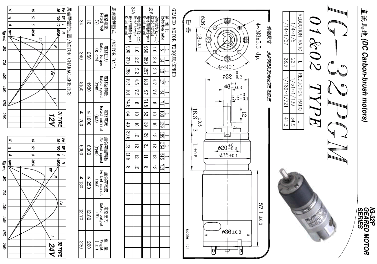

My motor is the IG32P 265 RPM from superdroidrobots (http://www.superdroidrobots.com/shop/item.asp?itemid=534&catid=76).  The data sheet is here (http://www.superdroidrobots.com/product_info/IG32P.gif).  I don't have a clue what the inductance is.  I assume it is fairly low since there is no decay curve in the current waveform.  I figure the 470 mH will get it up to 500 mH or close enough.  If it is too sluggish I will try out the 220 mH to see if it does enough smoothing to work.  Do you know an easy way to measure the inductance of a motor?
