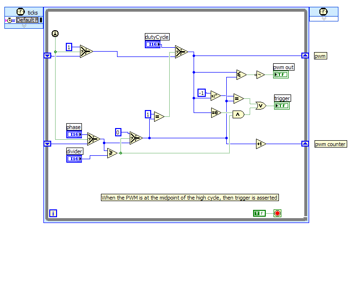

        I am using NI PXI FPGA module, PXI-7833R. Which is having 96 Digital IOs. In my application i want to synchronize all IOs, and generating PWM waveform with user diffined  phase difference. I tried to run each IO in separate while loop but it is creating synchnonization problem. Is there any way i can synchronize and generate PWM out put with phase shift.

put all of yor pwm generation code in the same loop so all the IO get written at the same time.  I would write a subvi like the image below then put as many instances of this in the loop as you need.  This example has phase control and a midpoint trigger (you may not need the trigger).

         Thanks for help. One thing i would like to know that, this will be like parallel loop only, Is it? As i understand  if we make subvi and use it in a single loop. It will work like parallel vi for each IO in a one parent loop.

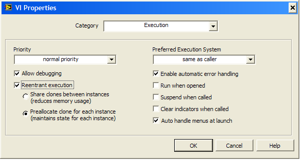

If you make this into a sub vi, set the vi properties to "reentrant execution".  Then make a copy for as many channels of PWM you need.  Then they will all run in parallel.  you can place them all in side of one loop.   Yes you can use a simple DIO module.  The only limitation of course is the speed of the DIO module.
