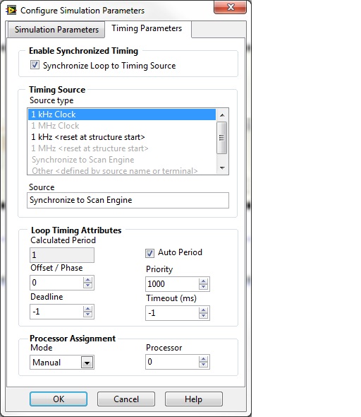

Yes it is necessary. But you have to synchronize control loop with time loop. Please follow the steps which you can find inside the tutorial - link I send - first link I sent you.
Generally, you should configure control loop like you will find in attachtment to this post.
Good luck
Cezary
configuration of loop
