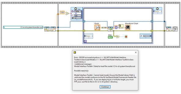

I have some big trouble when i want run model on compactrio. Lets start from beggining. I followed many topics about model generation from simulink model a I believe I download correct software versions. In simulink everything is set up according to related topics (NIVeriStand_VxWorks.tlc,GNU toolchain,fixed step ...) so when i try to generate model everything is finished without errors and build is made successfully. Generated .out file is copied to CRIO location C:\ni-rt\system. Of course model interface toolkit and veristand is installed on crio and development computer.
But when i try to run the VI where model is open, following error appears:
Model library is valid, i can connect via ftp. The second statement is somehow unclear to me, maybe this is the part of the problem. I tried reinstall CRIO model interface toolkit and veristand and it didn't help. When  I look in the CRIO folder :C:/ni-rt/NIVeriStand/ there is log file:

Does anybody know what it mean and how to solve it or how to deploy system configuration for crio?
Second interesing thing is that if I create model as standart windows library DLL  and deploy VI on PC then everything works great.
