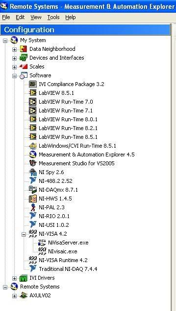

I finally found the LV RT software for the controller. Do I still need the FPGA to in order fo me to see the cRIO in the "add target and device" when I start the project? After searching I found that example below (RT Project Provider for cRIO) is required so I re-installed the NI-RIO and made sure it's installed but did not solved the problem..

From your screenshot of your installed software, it looks like you are using LabVIEW 8.5.1.  If this is the case, you will need the 8.5.1 versions of both the Real-Time and FPGA modules. Real-Time will allow you to target and program the cRIO the controller, but to program the FPGA you will need to FPGA module.
It's my previous LV version then I change it to 8.2.1 when I loaded the RT.
So this means that I don't need FPGA in order for me to use the controller? Thank for clarification..
