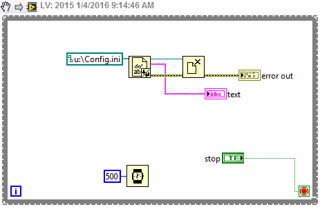

I have a PXI chassis running RT (the non-linux version).  I made a VI that all it does in a loop is read the u:\Config.ini file and show the text from the file.  When I first run the code I don't have the USB plugged in so it returns an error, and the text is empty.  I then plugin the USB drive and it shows the text in the file in this case I put the string "test".
Then I unplug the USB drive (the error comes back and text is empty as expected) and plug it into my PC, open the Config.ini in Notepad and change the file to contain "blah".  I save the file, close Notepad, and safely remove the drive.  Then I plug it back into the PXI chassis and after a few seconds returns the text "test".  I unplug it and plug it into another port and it still returns "test".  If I stop the VI with the drive plugged in, and start it again it still returns "test".  But if I stop the VI, unplug the USB, run the VI, then plug it back in, it reads "blah".
So what is going on here and how can I stop it from happening?  Why are files being cached in this way?  I could see a scenario where a user plugs in a drive with some settings on it into their computer, change some settings and plug it back in, without restarting the chassis.  In this case it would return the wrong information because it didn't read from the drive but instead read from the cached version.  Thanks.

If you are not doing it already I would suggest you try using some error handling to try and close the reference to the file you created, once the USB device is disconnected, since that could be preserving a copy of the reference in memory as you suggested.

I just tested this code this morning and it exhibits the same behavior.  Attached is the code on the RT chassis.  If I plugin a drive that has a file on the root of the drive that is Config.ini this will show the file contents and there is no error.  Then if I unplug it, plug it into my Windows PC, change the file contents, save it, safely remove it, and then plug it back in the file contents are what was read the first time, with no error.  If I then stop my program, and restart it, the text read from the Config.ini is the new contents.
If this really is a bug and not just my misunderstanding I could see this being a big issue where you plugin a drive that has some text file and the program is meant to append newly read data to it, but when it goes and reads the file, it doesn't read all that is there and there is potential for data loss.
