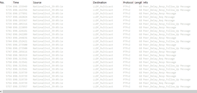

I analyzed the traffic using wireshark.
Below is a picture with an opened ring.
In general, nothing special. Ping and something else.
But when I closed the ring, there was too much of this "something".
It is interesting that after disconnecting the controller from the network, this "something" continues to be on the network.
Then a little google, where I found that PTP (Precision Time Protocol) is a protocol used to synchronize clocks over a computer network.
I tried to exclude everything related to time synchronization from the software that is installed on the controller. In my case, it turned out that I had NI-TimeSync Time Reference for IEEE 802.1AS-2011 installed and it was enough not to install this component.
After that, ping and modbus started working well.
Specifically for my tasks, where controller synchronization is not important, this is quite sufficient. 
