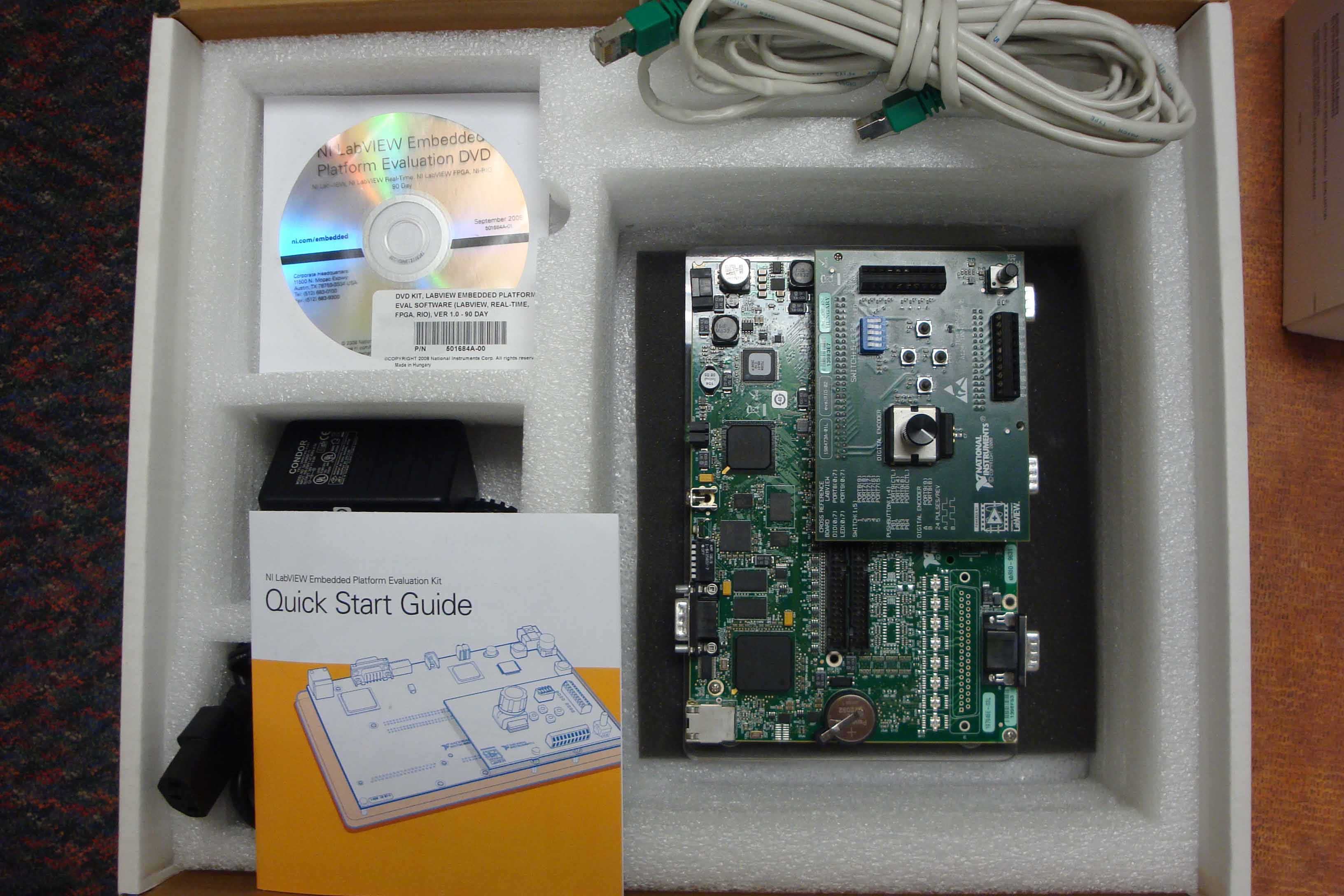

Rio Evaluation 101 board from 2011 - I need drivers
I have the Rio Evaluation board. It's this one:
I don't have a dvd. I use labview 2017 and I have MAX installed. I guess I need to instal RT and FPGA modules (2017???) and a device driver. Which one? The newest I have found is from 2015. Will it work with Windows 10, Labview 2017 and my device?

Based on your blurry picture that appears to be an sbRIO 9631. Here's the user manual:http://www.ni.com/pdf/manuals/375052c.pdf
I see a CD in the picture, have you taken a look at what's on there?
You can use LV2017 if you'd like but you'll also need RT, FPGA, Xilinx and the cRIO drivers
Xilinx isn't compatible with Windows 10 so Win7 is recommended. There is a workaround if needed that involves using cloud compiling.
