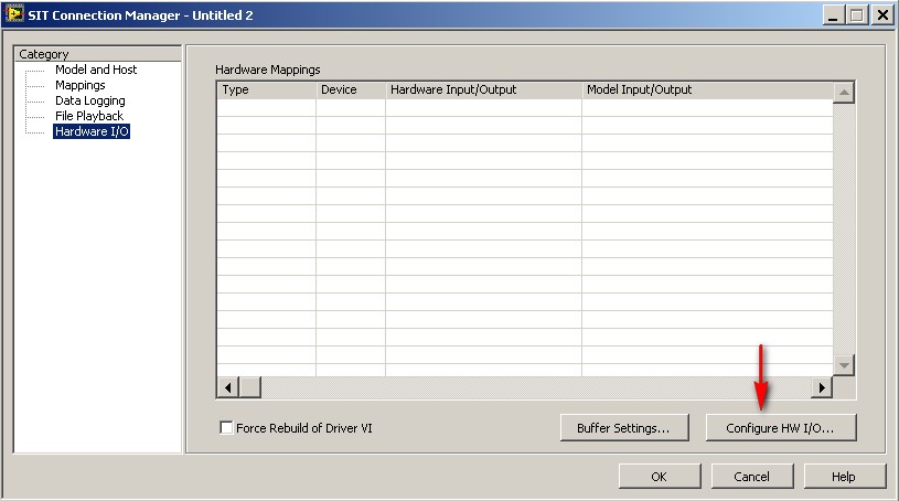

After looking at your code in more detail, I believe that you are using the SIT Communication Manager. When using this, there is an option called Hardware I/O which will allow you to connect your hardware to your DAQ board. I have added some instructions how to implement this below but if you are looking for more information on it that isn't include here, the help file has a detailled explanation how this manager works.
How to add Hardware in SIT Connection Manager:
1.) Open the SIT Connection Manager and add simulation DLL.
2.)  Under the Category list box, Click on Hardware I/O.
3.) Click Configure HW I/O as shown in the picture below:

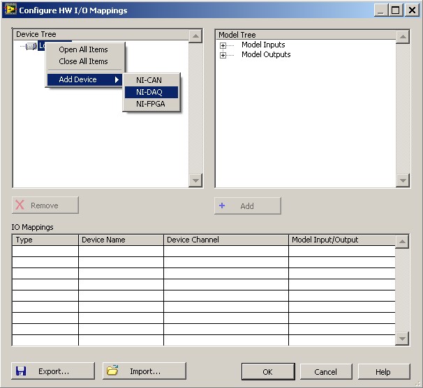

4.) This will open a new window where you can add your hardware. Right click on Local Host and select Add Device>>NI-DAQ.
5.) In the NI-DAQ Device properties, you can type in the Device Name of the card and how many analog inputs, outputs, etc. Click OK when finished. This can be seen in the image below:
 6.) On the Configure HW I/O Manager, click on the analog input, analog output, etc under the device tree and also click on the corresponding simulation input/output on the Model Tree.
7.) Click Add to create this connection between the hardware and the simulation model. The picture below is what the Configure HW I/O Manager will look like.
I believe this will help with the execution speed. If you have any more problems, feel free to post so we can work on it.
