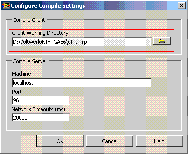

I've find the problem by myself!
I remembered that I must start the Xilinx compile server once with administration privileges for complete activation.
Normally I've no administration privileges.
Problem was the "Root build directory" in the configuration of the compile server (the default value for this setting is "C:\NIFPGA86" under LabView 8.6.1) within this directory I've just limited read/write privilegs so that I've changed this "Root build directory" (see picture) to a directory with full read/write privileges and than it works!
After this I've changed in the configurations of the "Compile Client" (see "FPGA Module Options" of the projekt) the "Client Working Directory" to the directory seeing in the next picture:
After this the compiler works and generates the bitstream file successfully!
Thanks for help!
Best regards Patrick Röth
