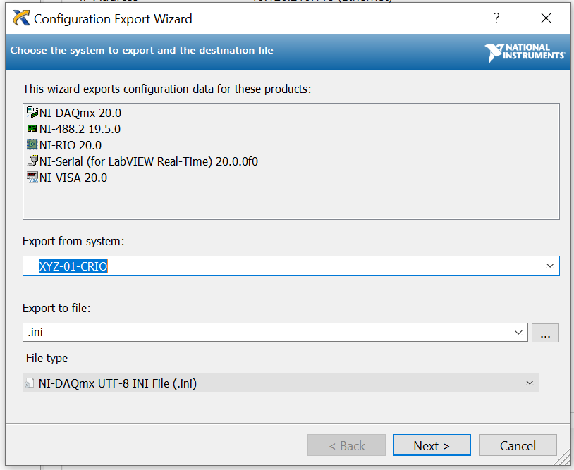

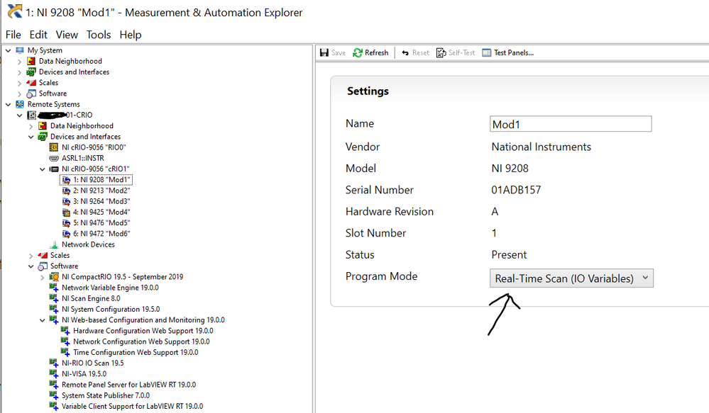

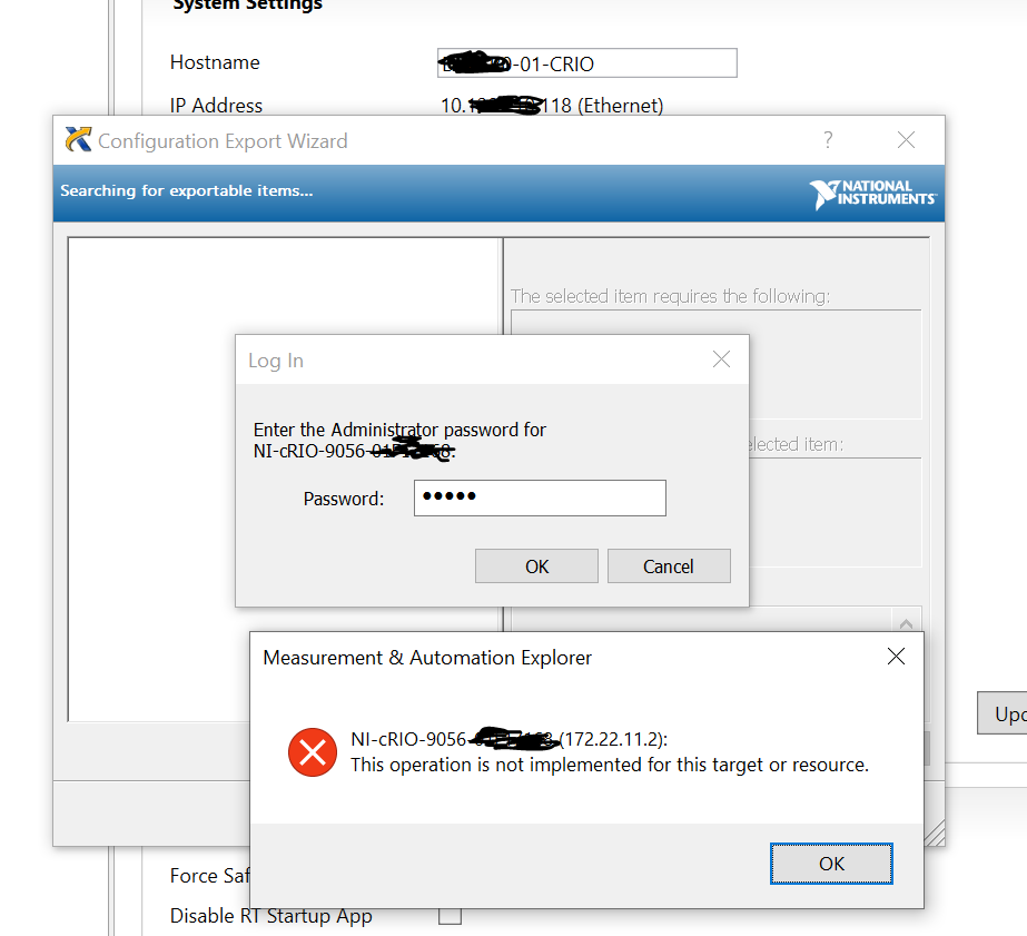

I tried your suggestions and compiled a screenshot showing the installed software.
The screenshots below show in order:
1. The installed SW and the module programming mode of Mod1 for the imaged system (no DAQmx installed as it isn't used)
2. The Export dialog showing it wants to export data for software that isn't installed.
3. The failure message, most likely due to the fact that DAQmx isn't installed.
In conclusion: Export and import isn't usable to correct the programming mode, I wasn't able to verify if it would also correct the default J type TC to the image's K type.
