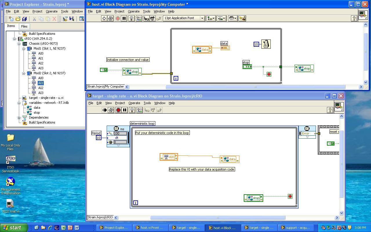

Ok, so here is a little more info.  I used a basic Real Time program here built from an example.  This is a screen shot of my host VI, as well as the CRIO VI, and the project explorer as well.
This is pretty much the basic real time wizard set up for input/output (the one with the sine wave, which I got to work and display fine).  Can I not just drag and drop my input from the project explorer right into the VI on the compact rio?  This is what I did, and on the digital display my voltage stays the same.  Do I need another whole VI to aquire the strain and then give it to the CRIO VI?  (like the sine wave example).  Here is a screen shot of what I have.  I just cannot get the voltage from my strain gauge to display on the front panel.  Any help is appreciated, I'm half bald from all the hair I have pulled out.
Message 5 of 8
(5,515 Views)
Shoot, I posted the wrong picture.  Shortly after I realized when I made this program I didn't switch the variable to write in the acquire VI.  I switched accordingly, so that the acquire was write, and the host VI variable was read, so make that switch in your mind if you are looking at the above picture.  I tried again this morning and still cannot get my strain value to show up at all.
Message 6 of 8
(5,491 Views)
Hi MechHead,
Let’s try adding some error handling to your existing VIs, so that we can better understand if there is a bigger problem. In your Real Time VI, pass the error wire into an Unbundle by Name function so that we can monitor the Status component of the Error Cluster. Wire this to an Or gate, and wire that output to the Conditional Terminal of the While Loop. Wire your Stop variable to the other Or gate terminal. Here is some code that describes visually what I just typed out:
Finally, in your Host VI implement the same architecture. Additionally use the Simple Error Handler VI to observe the Status, Code and Source of any errors that may be occurring in your Windows host VI. What, if any, are the error codes/sources generated?

After re-hardwiring everything I finally go signal to come through.  I never did get an error from the error handler, so I assume my programming was correct all along.  As far as wiring, I did not change how I wired stuff, I just re-completed the connections, so apparently this is what was causing my headaches.  If I have any further help I'll ask away, till then - hanks for the help!
