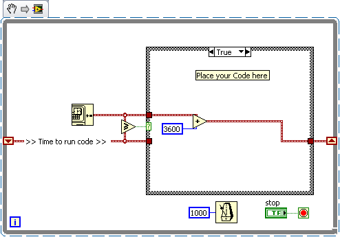

I will build a real time aplication and i want to work for few minutes every one hour automatically. Does anyone has any idea how to do that?

Use Get Date/Time function to get the current time, run your code, set a shift register with the absolute time at which to next run your code (add one hour to the current time). In every loop compare the current time to the shift register. When current time is equal/greater than shift register time, run your code and update the time in the shift register.
In the False case the current value from the shift register is passed straight through.

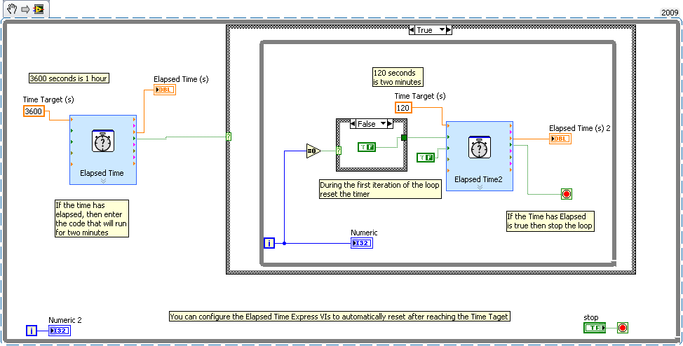

Hello Christian,
thank you for the reply i will need a little more explanation.. the constant 3600 indicates the seconds (total one hour ) which i want my code to ''wake up'' and run?  for example if i want my code to run for 2 minutes every one hour where i have to insert the 2 minutes and how, as an input of the greater/equal ?

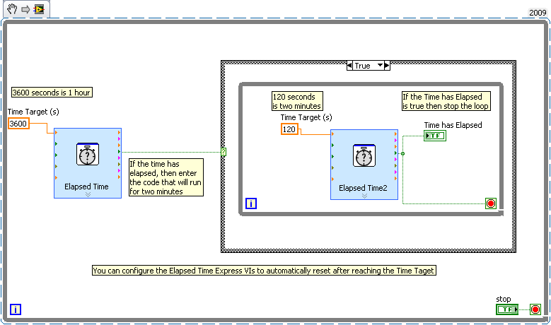

Hi Zaxos,
You will then need to add more logic to the example. I hope this does not add to the confusion, but I have elected to use the Elapsed Time VI:

Hello Joshua,
I tried that method and i think is working proberly only the first time. In the second cycle of the elapsed time 1 (at the second hour in this example) the case structure become true again but the internal while loop is not working because has already been stopped.
Do you have any idea how to fix this problem?

Hi Zaxos,
You can add a bit of logic so that during the first iteration of the inner loop the Elapsed Time VI is reset. If you are not wanting the first Elapsed Time VI to keep counting while the inner loop is executing then you may need to add similar logic.
Since it sounds like you are new to LabVIEW I recommend going through a LabVIEW Training Course. They range from free self paced training to instructor led training.

Thank you Joshua,
This is what I needed...
