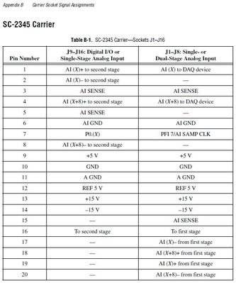

When you say the break out connectors, are you speaking of the connectors where the modules plug into, and if so, should I be connecting the input and neutral as per the following picture?
Image taken from SC-2345 manual: https://www.ni.com/docs/en-US/bundle/sc2345-2350-seri/resource/371064f.pdf
Would I therefore connect the input to pin 1 (AI (X) to DAQ device) and neutral to pin 3 (AI SENSE) on one of the J1-J8 connectors? I don't need to worry about blowing the sc-2345 at all do I?
I highly appreciate the help you are giving me with this, as it is saving me a lot of time, hassle and money. Thank you.
Message 5 of 8
(7,480 Views)
The SC 2345 have terminal blocks on the side (not where the modules plug in) which are straight feed throughs to the DAQ board. The terminal block connectors bypass the signal conditioning on the SCC so you can access the DAQ board directly. This means that you can put crazy voltages on the device, and the SC 2345 would probably be fine but the DAQ device would become toast. You would need to verify that your signal is within the voltage and current for the 6036E, otherwise you can damage the device inside yout PC. If the signal you are measuring is too big, then some signal conditioning (thus the signal conditioning connector block, or SCC block) would be necessary/desireable. You may also want to find a EE friend to help talk out some of these things if voltage levels are going to be a problem and you don't feel comfortable with the wiring concepts.

I thought you were talking about the terminal blocks, but I could not find the connections you were talking about:
There is an AI SENSE, but no AI 0...
When I looked at the 6036E manual, it says up to 10V, but the minimum voltage for the sensor is 10V, so I think that dream is dead. SCC-A10 it is.
Thank you for all the help.
Message 7 of 8
(7,461 Views)
Oh you are right, I mixed up the 50-pin connector with the 68 pin connector. How embarassing.
