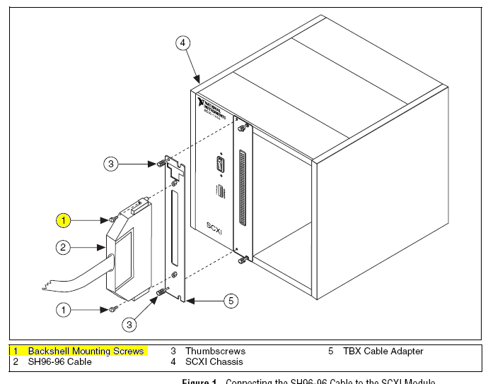

Here is an illustration of the screw I am talking about, got this image from the TC-2095 manual.
Message 5 of 8
(7,937 Views)
Aside from the standoffs diagrams linked in my first post, the only information I've found on the screws you mark is the information I've found on the TBX Cable Adapter. Particularly, the TBX adapter has 2 standoffs the locations you mark as (1). They have the description of "CUSTOM SOS M2.5 X .5 X 5.5MM."
