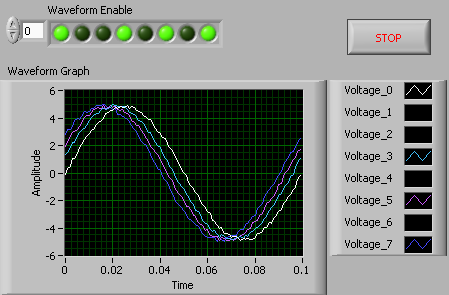

Now that I have everything synchronized I need to display the 32 channels that I have acquired.  How would you go about displaying 8 or 10 waveforms with the ability to choose which channels you want to display on the graphs.  I am sure this is fairly simple, but I am just a beginner and can't find the option.
Message 4 of 15
(8,840 Views)
Hi avasque2,
Attached is a simple example that demonstrates how you can dynamically change which channels are displayed on a waveform graph.  You can also modify this VI to only allow static changes prior to graphing.  To do this, simply move the FOR loop outside of the While loop and delete the array initialization procedure.  Let me know if you have any questions!

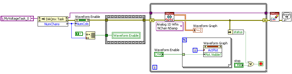

Hi avasque2,
Unfortunately, I do not have DAQmx support installed for LabVIEW 7.0, so here are the screenshots:
Front Panel while running:
Block Diagram:

I built the diagram using labview 7, but I am having trouble creating the indicator coming out of the for loop.
Message 9 of 15
(8,751 Views)
I mean the Control into the FOR loop
