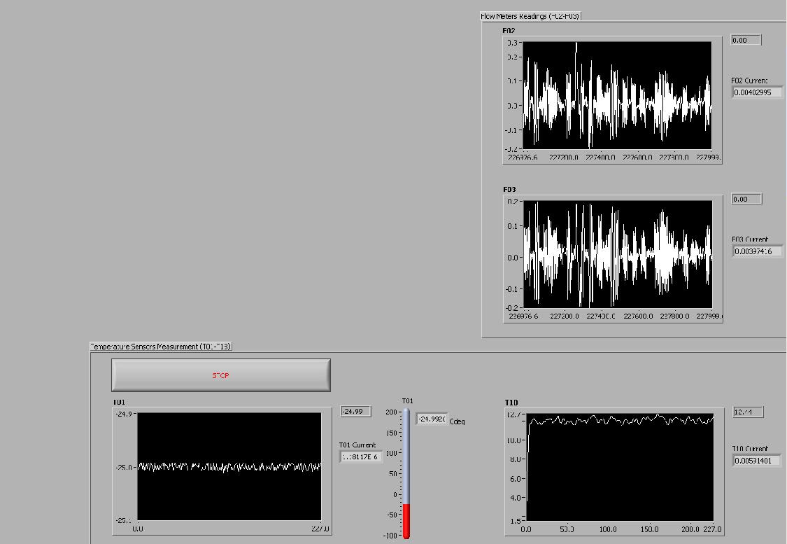

I am trying to get rid of as many riplles as possible from my measurents but i am stuck. I dont know which filter could be ideal for this matter. I have done everything possible in terms of hardware to eliminate the noise but i still have some noise in the system which i would like to reduce using Labview.
Please have a look in my vi and suggest me what filter could I be using to smooth my signal.

Here's a picture of my noise signal (the first two signal are measuring zero, but the noise is the same when i measure non-zero values)

The hammer for that nail (noise) is averaging.(Lowpass filter).
However some important informations are needed:
Samplerate and how fast is the system?
How fast you need a value? Phase margin?
Even more can be done with fitting, if the type of signal is known.

Thanks for your answer.
I am running my system at rate=6000 and reading 1000 samples/sec.
I have tried to put a low pass filter but hasn't solved the problem.
(6,939 Views)
What is the bandwith (highest expected (meaningfull) frequence) of your signal?
