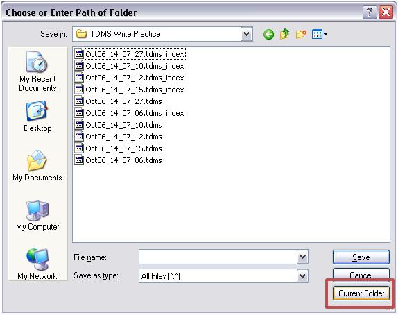

However, I found the problem - Err118 with TDMS Open.vi, indicating that the supplied folder path does not exit. I check your original VI which has the same problem.

I wasn't able to reproduce this.  Make sure that you select the correct folder.  Take a look at the following screenshot:
Make sure that you select the current folder for the TDMS write.
Jim Schwartz

Fantastic, it's working properly. I also downloaded the TDM_excel_add_in to open the file in Excel.
