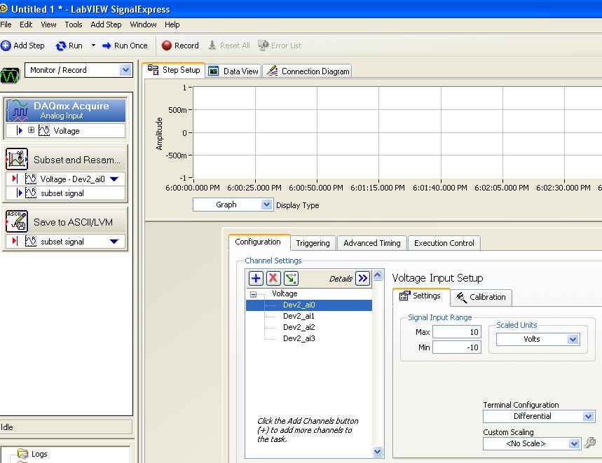

Below is a picture of what I believe you are trying to do in LabVIEW SignalExpress, and I do not have any issues with inputs to other functions. I am a bit confused when you say ‘The logged data created from the scale step is empty…’ Can you please post your project and screenshots of your results, as this will allow me to analyze your code as well as try to reproduce what you are seeing. The more information and different screenshots posted, the more I can understand and analyze the issue.

I took a look at your project, but unfortunately cannot correlate it to what you wrote in the post as there are no steps in the playback mode, therefore no averaging or saving will be done. There are also no conditioning steps in the record mode – only acquisition steps. I would like to ask that you post screenshots of the ‘blank’ logs, and any ‘lockups’ that you have. There is no need to embed them into the post – simply attaching them is fine. Feel free to attach as many pictures as needed for a detailed explanation of your results and what is wrong. (If you would like to know how to embed pictures as I did above, please see this post
Attached is a project that I made, which I believe to be similar to what you are looking for. (Acquire & Log data, and then in the Playback mode – scale it, and do some averaging with  the data). Please try this and post back your results, and if you get any blank logs. Do these blank logs have absolutely no data, bad data, all points are the same data? Please explain in detail.
