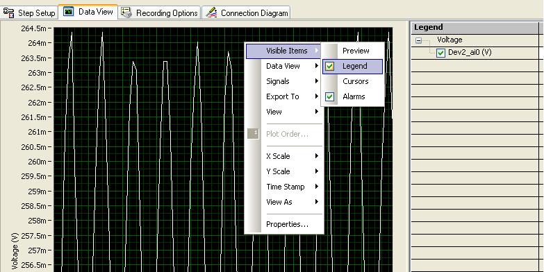

The direct definitions for the ‘block size’ and ‘ignore last iteration if partial’ can be found in the help file (Open SignalExpress >> Help >> LabVIEW SignalExpress Help – see picture below). Basically, the block size is how many samples at a time the file will be cut into. The ‘Ignore last iteration if partial’ will setup SignalExpress so that if the last iteration is not a full iteration (does not have enough samples for an entire block size) it will not be processed. This is why we thought you may be seeing ‘blank’ samples.
I would like to take a step back to a slightly previous post, where it seemed like the issue was resolved, except that 2 signals were missing. Is this still the case that we can pursue? I would like to get a more clear definition on this, and therefore ask for another picture, line NI_9, but showing the legend as seen below. This will let us know how many channels are being graphed, and if a channel that you are expecting is not being included (This is what I interpret by 'missing 2 signals' - 2 channels are not being graphed). I would also like to ask for your latest SE project, along with the data files so I can see what is missing. The files are stored here: C:\Documents and Settings\UserName (All Users, administrator, etc)\My Documents\SignalExpress Data.
